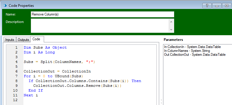

4. how to delete entire coloum from collection including header

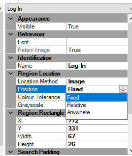

5. how to click button using surface automation whose position and colour keeps on changing.

4.
Johan Michiels
Mr
BGL BNPP Luxembourg
In addition to Johan's answer I would recommend using the collection manipulation object for question 4. It can be found Digital Exchange or with the link below:
https://digitalexchange.blueprism.com/dx/entry/3439/solution/utility---collection-manipulation
It gives you a lot of benefit in terms of working with collection without knowning the specific codes.

5. Surface Automation there is an option to select the position of your image. When you select Anywhere it will search the image in the entire region.
23643.pngand for the color, there is an Option of Colour Tolerance and Grayscale option that you can explore.
You can check in detail the course on surface automation at blue prism university.
