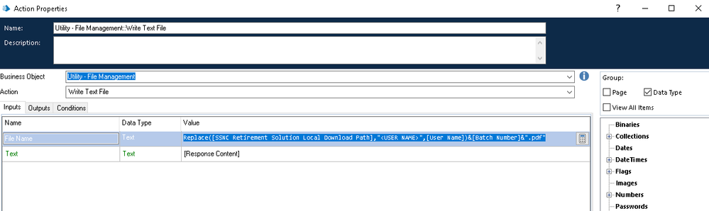

Hi Kadali,
If your response is a text/plain then use the below action to save the response as PDF.
