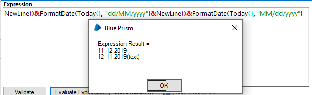

11-12-19 10:10 AM
Please be aware of different behavior of FormatDate depending on your regional settings in Windows.
Below is the result of non-English date format settings in Windows and format vs resulting string.
