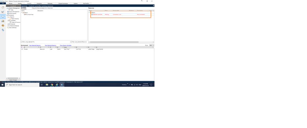

I am new to BP and started using 30day trial version of BP 6.7.
I was in following Blue Prism Foundation Training and tried to publish a process from Studio.
But, when I checked in Control Room, it seems my Resource is not connected.
Can someone pls help me with this?
Is there any limitations of control room in terms of BP Trial version?

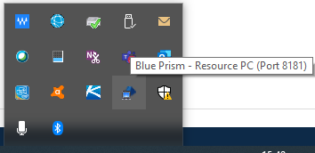

There could be a few reasons why this is happening, so let's start with the simplest to check.
If not, do you see Blue Prism Resource PC in the icon area of the Windows Taskbar?
Carl Carter
Developer Program Manager
- Access Blue Prism > System > Settings
- Ensure that the Start a personal Runtime Resource on this machine when users sign in to Blue Prism is checked
- Close all session of Blue Prism
- Open Task Manager
- In the Processes tab, Look for any sessions of Automate.exe; End Task for each of the found sessions
- Open Blue Prism and Sign In

Thanks a lot ! Appreciate your help.Resource is showing connected now.
