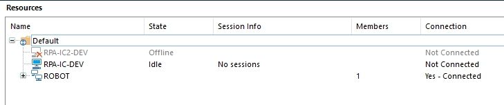

I have resource (RPA-IC-DEV) state is Idle but Connection is Not Connected.
How to fix resource?

Hi there,
The "Idle" state that you're reading is coming from the last known values in the Database, where as "connected" comes from the heartbeat between application server and runtime resource. Right now, assume that your resource is not connected, restart it, and check to make sure there's nothing preventing communication between the two points.

Hi Charles Trott,
Thank you very much for support.
After restart vm resource connection is "Yes - Connected".
