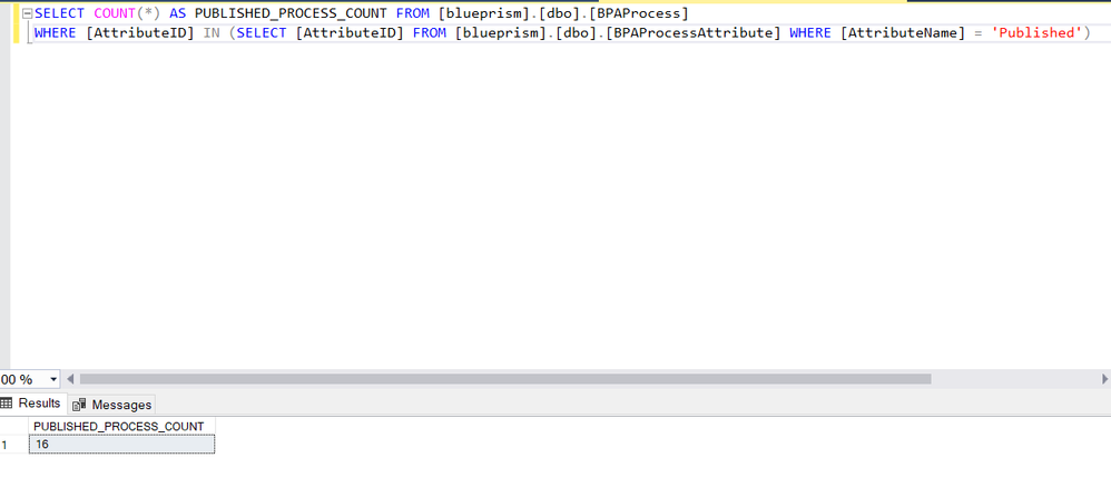

You can try to execute the below query to get the desired result:
SELECT COUNT(*) AS PUBLISHED_PROCESS_COUNT FROM [blueprism].[dbo].[BPAProcess]
WHERE [AttributeID] IN (SELECT [AttributeID] FROM [blueprism].[dbo].[BPAProcessAttribute] WHERE [AttributeName] = 'Published')​

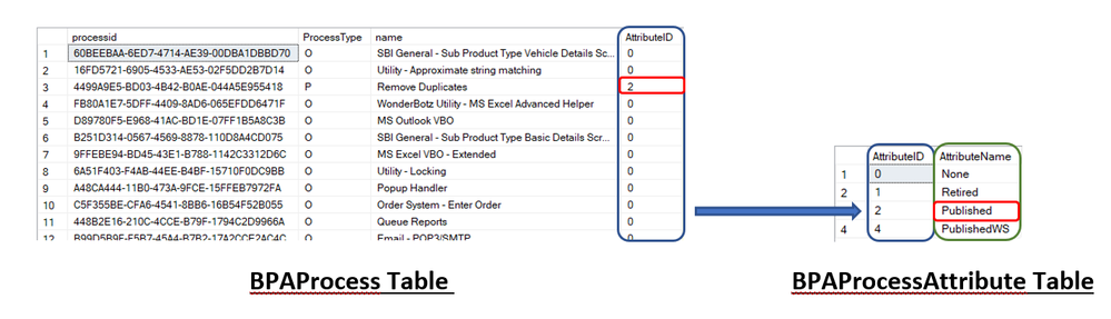

Basically what this query does is it will try to look for the count of 'AttributeID' column in your 'BPAProcess' table where the 'AttributeID' column mapping is present in the 'BPAProcessAttribute' table where it indicates that the value '2' is equivalent to being published:
