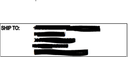

I have a PO document(pdf) where the address data is dynamic in rows, Address may be in 3, 4 or 5 lines. In DFD we are assigning with multiple lines for the address field and trained with all format files in sufficient number (~100). But every time a new batch is loaded, decipher able to read only a few documents(40%) with correct address. for others either it is extracting less rows of data or more rows.
Eg: Decipher is reading only 3 lines in 5 lines of address data in a single block, or 4-5 lines in 3 line address.
refer below screenshot:
Any suggestions to improve the accuracy?

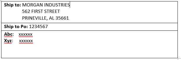

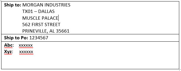

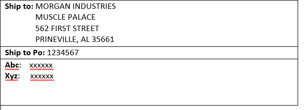

Hi Ben,
The layout is changing as per address (no of rows), So after using "StrictPosition=On" decipher is reading the extra lines in case of 3 rows of address. We have tried to use other options like "Semantic=On" assuming will consider outline and stop reading the unwanted data. Still not able to achieve.
Appreciate any other suggestions.
FYI the pdf loos like below:
4 rows;
3rows:
5 rows:
After training the above formats , if we have batch with all the 3-address format of pdfs. Our target is to read only the address (Ship to)correctly.
Scenario 1: For some(3 lines of address file) decipher reading the values of ship to po as well considering it as 4, 5 lines.
Scenario 2: For 4 lines of address file, it is reading either 3 lines or ship to po as well considering it as 5.
Scenario 3: For 5 lines of address file, it is reading either 3 or 4 lines.
I hope you got the issue,
Note: We have connected with decipher support team, but the issue still persists.
Kiran.

Most of the address are in US region. We cannot create a list since they are customers, can be new address.
Can we use any regex to identify as address as a whole...?
Note: The provided addresses are manipulated in the above screenshot.
