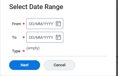

I want to apply leaves by clicking on calendar button and selecting dates. Pls suggest how to do this? I am not able to select.
I was creating the bot by using "navigate". But it gives error that way. Its not working with below bot.

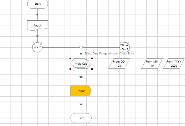

In Application modeller, I used UI Automation method to spy the elements. Now this time I did not open calendar. Instead I spied each and every element (From DD, From MM, From YYYY). I have pasted the screenshot of the elements I spied below. Also pasting the screenshot of bot I created. In the bot, I am calculating current date and trying to write in the "From Date" box in screenshot 1. However, when I write, then it gives me below mentioned error.
Could you please help here.
"Internal : Failed to perform step 1 in Write Stage 'Input' on page 'Input leave data' - Unable to find a valid pattern - required: ValuePattern"

Hi Swati,
The error message indicates "ValuePattern".
I believe you have already tried writing the full date in the required pattern DD/MM/YYYY and it didn't work?
For existing code:
Maybe try inducing some delay and write DD, MM & YYYY in individual Write stages because I am thinking once you enter DD that's when "/" gets activated and similarly, once you enter MM the second "/" gets activated
or
you can do the entire thing in one Navigate stage using Global Send Keys along with Delay as well.
