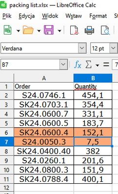

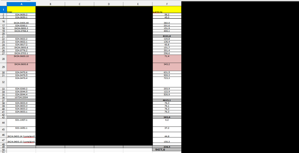

I would like to make project which it will be removing rows from excel file:
 based on another excel file:
Any ideas how to compare this tabels and remove orders from 1st. IMG based on second IMG?

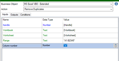

To remove duplicates from excel you will need a new action in your excel vbo on blueprism. I built one previously and it should be easy enough for you to replicate. In your excel vbo create a new page and add a code stage then add the code (shown below), add your inputs as Handle, Workbook, Worksheet, Reference (this is the range you want to remove duplicates from), Column number (this is the column you want to remove duplicates from). Add these same inputs to the start icon and then publish the action. This should then be able to remove duplicates in the excel worksheet for you, code and screens below.

Hi @bazygon
