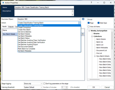

As shown Below I have used this activites.
2 weeks ago
Hi Team,
As I'm using Decipher IDP 2.3 ,
In Decipher VBO , I think there are some actions missing.

Hi @Abhi-Chattar ,
Have you completed the Decipher training on Blue Prism University? If not, I would recommend starting your Decipher learning there as it covers the foundations of using Decipher.

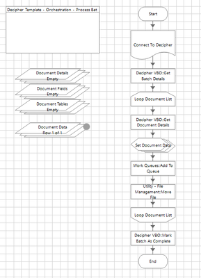

Once a batch has been submitted in the Data Verification screen and is showing as Awaiting Export in the admin panel, you use Get Batch Details to get the Document List, then loop through the list with Get Document Details. You can then add the extracted details to a work queue.
Which actions do you think are missing from the VBO?

Something like this will work

There were sample processes provided earlier in the Decipher downloads section. I hope that would help here for such users.
