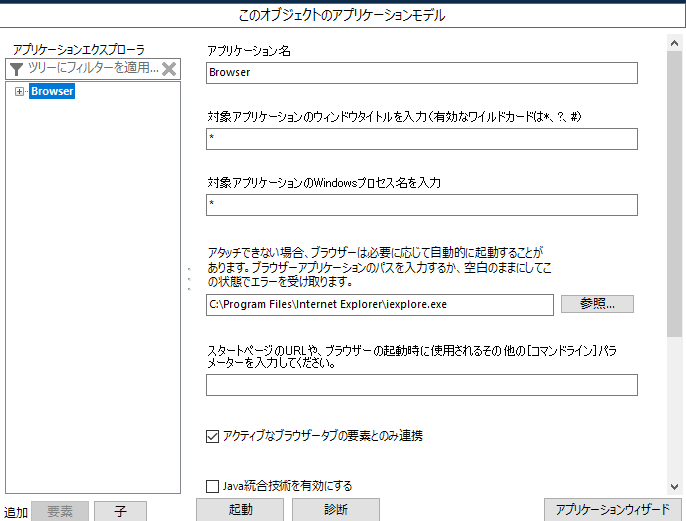

I needs to spy IE browser page.
But I cant attach it at all.
It doesnt attach , only start-up again and again.
It seems I am doing a basic mistake.

if you want to attach already existing IE, create 'Attach' action and use 操作 stage to attach

Thank you for your advice !
I solved the problem by creating Activate action of 操作 stage .
