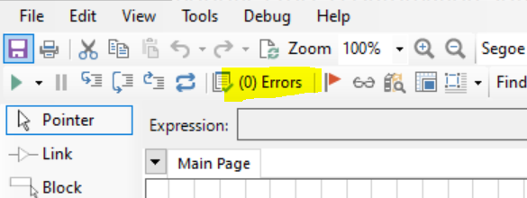

In Blue prism do we have any place holder to show us warning or errors for the process which we went live and in use

Hi Rajkumar,
Assuming that the process deployed in production should be available in lower environments like UAT/DEV, you can view if there are any errors in the process design in process studio.

Thanks Shashank, is it best practice to clear all errors and warnings.?

Hi Rajkumar,
It would be best to clear all errors/warnings as much as you can.

Just wanted to add my two cents. It is certainly best practice to clear all errors, but I do not think warnings need to be cleared. They are just warnings that you should be aware of. It would be a good idea to review them, but I could list several if not dozens of scenarios where it's impossible to clear all the warnings. (That is, assuming you haven't edited the configuration of the System tab's settings for Validations)
