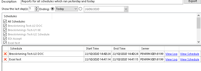

Hi Blueprism support hope you can help me with the issue.
​There are sessions already consuming this license. Any session in pending or warning state will use one license. (where can i see the session is it in blueprism)
There might be private resources used in Control.(Where can i see that. Nothing should be running in control)
Depending on how your process and your schedule have been built, two (or more) processes might be started at the same time (or started before the previous finished)
Nothning is running
There was a recent change if license keys without restarting Blue Prism service( no change in licence key)
The password of the user credentials used to run Blue Prism service was recently changed without service restart (no change in password)

The status of the processes are shown in Control tab in Session Management / Today (the very first node in the left hand side tree menu).
In the bottom right the process status is shown. Sometimes it happens the pending (or warning) session is not shown anymore in the current view because eg there is a filter on the last three days and the pending state is since last week.
In the Analytics tab you can also add a tile to a dashboard showing current license consumption.
