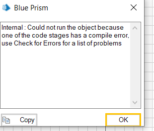

Internal : Could not run the object because one of the code stages has a compile error, use Check for Errors for a list of problems
marwagamal

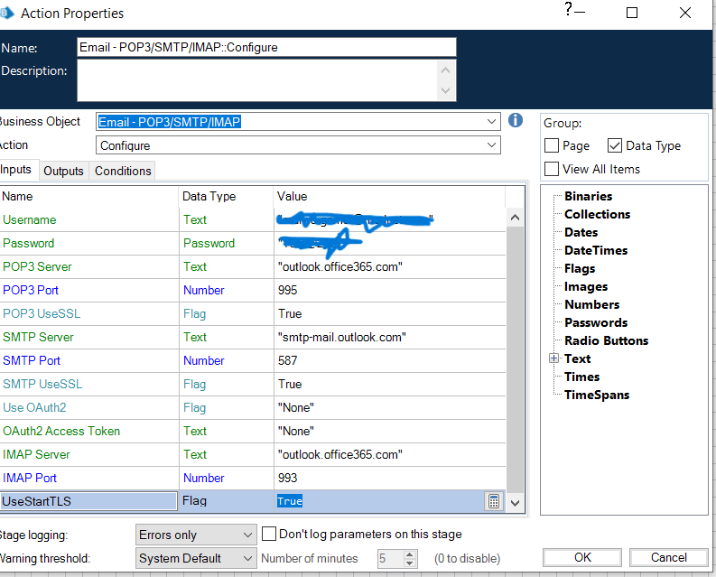

Hi All,
I'm new to BP and i have issue when I'm trying to configure Email - POP3/SMTP/IMAP I got the error in the attachments, i also attached the configuration step to kindly check if there is something wrong.
thanks in advance.
marwa gamal
Hi marwa gamal,
I can see you are sending string "None" for OAuth2 parameter  it is expecting flag either True or False.
 I would correct that and try again and see whether you are getting the same issue.
