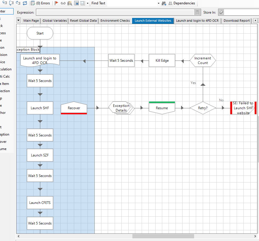

Is there any limit for the number of edge instances which we can launch, we have a project built which was working fine until previous edge update, let me explain the scenario below:
- We use four different web applications in our project
- All the websites need to be launched initially
- Bot is able to launch 3 websites in separate instances properly but while launching fourth website it is opening a new tab in 3rd instance and loading the website
- I have tried providing delays between each application launch but it doesn't work
- This issue is happening while running the bot in control room, in debug mode it is working fine
Any help is appreciated

We are using 6.10.3 version of BP and MS edge version is 114.0.1823.43
Below is screenshot for flow, please let me know if you need more information.

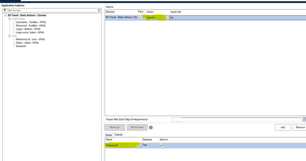

Are you using tracking ID for different instances?
