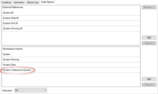

MichealCharron
Level 8
@maryam Ashkar,
What you are looking for is the namespace System.Collections.Generic and it is covered by the System.dll assembly.
