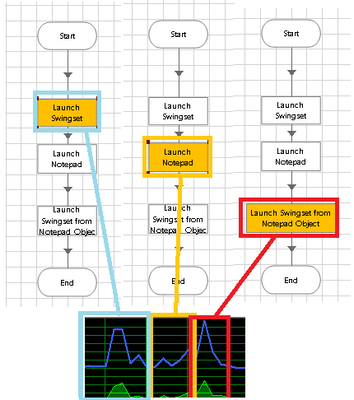

When a Business Object calls other Business Objects, Blue Prism appears to create additional object instances rather than reusing those already loaded by the Process.
From a performance and memory consumption perspective, is there any official guidance on how much object nesting is considered reasonable?

Second, object nesting is not a bad thing in most scenarios. The main reason to do it, from my experience, is when you're calling reusable utilities, such as you mentioned in your example. Depending on the complexity of those utilities, they are often tiny in comparison to that of full objects that automate UIs and stuff. Granted, a complex utility object can be the same size or larger than UI objects. Also, related to this, it is and has always been a standard that you should split up objects to keep them as small as possible both to allow multiple developers to work simultaneously as well as to keep memory overhead low. If your process only needs one action, then it's a bit unnecessary to have all the others loaded into memory -- that kind of thing. Straight from the horse's mouth (I mean Blue Prism here): "You can never have too many objects, only too few". Overall, in my experience, this will not cause any issues unless you choose to call a massive object nested and also if you go super deep into the nesting. If you stick to one or two levels and you're not heavily doing this, I doubt you will ever notice a difference except that it does take a moment for those object instances to load. All this said, I do often copy code over into an object to avoid the nesting, not because of total memory usage but to avoid that object instance load time because it is loaded at the moment the action is called and not when the process is initially started. This means that nested objects are not loaded as an instance until and unless they are actually called. Anyway, I don't think it's a problem to nest whenever it benefits you to do so. If you're unsure, just copy solid code into multiple objects. The idea of DRY (Don't Repeat Yourself) does not need to be followed rigidly. It is just a guideline to keep in mind to improve maintainability of code.

While it's true that Blue Prism creates a new instance of an object from each process/object that calls it, it does reuse the instance from each level/location where it is called from.
I'll do an example of Process A, Object B (OB), and Object C (OC). I'll use "->" to indicate left side is calling right side.
Process A -> Object B (new first instance of OB)
Process A -> Object B (reuses first instance of OB) -- this is as if Process A calls Object B a second time somewhere else in the flow
Process A -> Object C (new first instance of OC)
Process A -> Object B some action -> Object C (new second instance of OC)
Process A -> Object B diff action -> Object C (reuses second instance of OC)
Process A -> Object C (reuses first instance of OC)
In all that, there is only ever two instances of Object B and Object C. The main thing to recognize here is that Blue Prism does reuse instances from each level/layer/process/object. So, any given instance of a process or object will only ever create one instance of any other given process or object.
