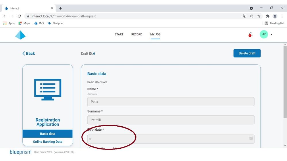

This is happening to me in version 4.2.0, when I retrieve in Interact a form saved as a draft, the value of the date type field is not being retrieved correctly. I thought it was something isolated but I tried again and the same thing happened. I don't know if it's already reported but if someone is using Interact it would be good to confirm the issue.

15-06-21 02:07 AM
The form is selected, the fields are filled in, a date is selected and it is saved as a draft.

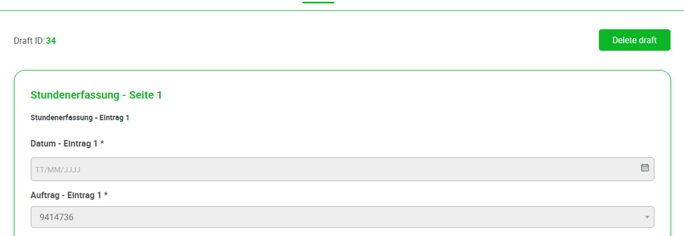

thanks for quick response. I am using Interact 4.6 (the most current version). I have Date-fields for a time-recording but when saved as a draft the entered dates vanish...

11-10-22 05:40 PM
Hi Joe,
sry for taking a while...
Now the Screenshot from the Field-Editing-View:
...and here the screenshot from the frontend-view after saving the draft:
Even though the draft was saved, the entered date (chosen via calender-function) didn`t save (instead the placeholder is showing)...I am using the OS with german settings...
