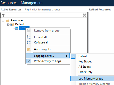

Hi, all
I have enabled 'Log Memory Usage' for my machine, expected I will be able to see where and when the consumption creeps up.
But couldn't find where I could find the logs
(Not found in seession log)
Does anyone have any suggestions on how to find the log that has memory data?

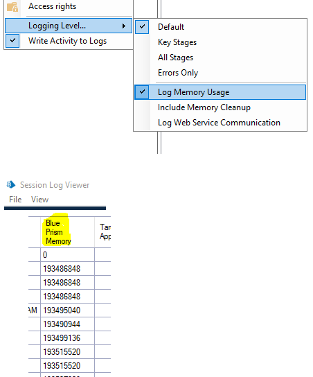

05-01-23 09:53 AM
Hi Yuna - display all columns in the Log Viewer and also check that the process is actually generating log data.

05-01-23 10:44 AM
Hi yuna,
Here you go
