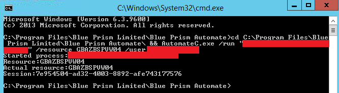

Resource GBAZBSPVW04 runs the /run command with the resource input as GBAZBSPVW04.  This then starts the selected process as expected.

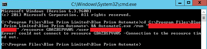

When the /resource input is changed to GBAZBSPVW05 and ran from '04, the following message appears.
From documentation on this topic and the information in the response from CMD, it looks like it should be possible.  Is it a connection setting that needs to be enabled for resources to be able to run processes from each other? If so, would this be a change made on Blue Prisms side or by our infrastructure team?

I have tried this in the past and had the same issue.  I have just tried again and using the local resource has no issues.  If I try to connect to a different resource, I hit a page cannot be displayed message.  This further points to the resources not being able to communicate with each other.

Did you change the default port? In our case we changed it and we had to open it in our firewall.
It seems you have the same problem in both cases.
