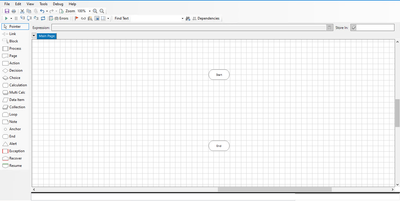

I'm having a problem with my Blue Prism. The refresh button, located on the toolbox at the top left of Blue Prism's process, doesn't seem to be working. I clicked on it multiple times and nothing happened. What might be causing this problem?

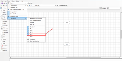

Also, the "Font" toolbox doesn't appear in my Blue Prism. I checked to see if it was enabled and it is. Can someone help?

Regarding the Font, I'm also not able to see that menu. I'm using 7.4
I found this in the Known Issues, so this should get fixed in the next version -

However, my problem is that the refresh button isn't doing what it was supposed to do. When I click it, nothing happens, the object references are not updated according to changes I might have done, data items remain with values, an so on. In fact, it appears that the reset button is functioning as the refresh button and the refresh button doesn't do anything.
Regarding the font toolbar, you cleared my doubts.
