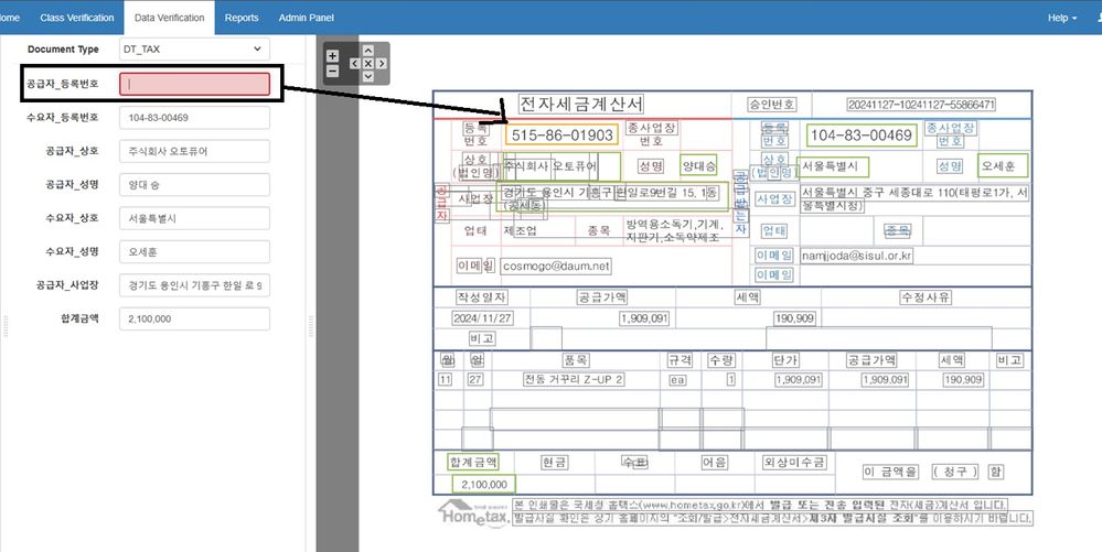

I’m currently working on automating the processing of invoice documents using Decipher IDP.
However, I’ve encountered an issue where data extraction fails for a specific field on the document.

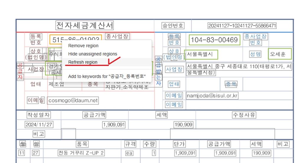

As shown in the screenshot, a bounding box is drawn around the invoice number, but the data itself isn’t extracted.

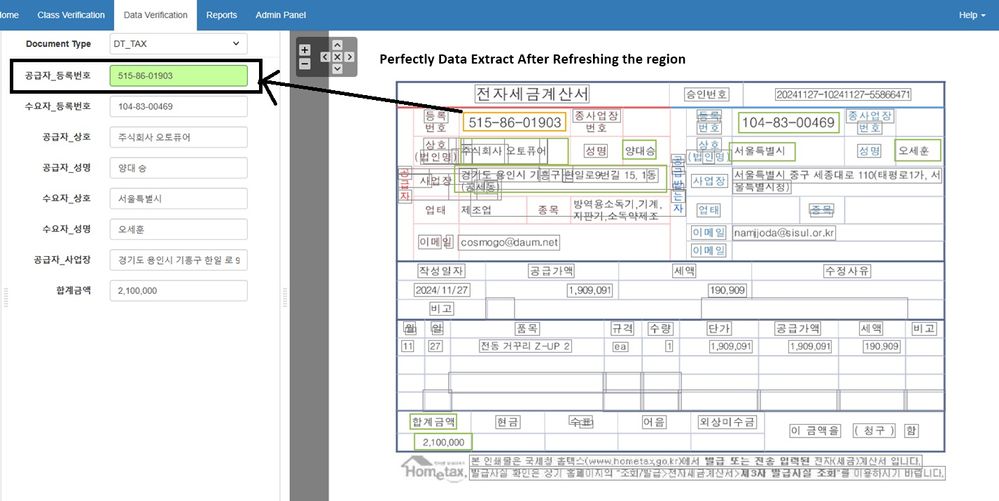

Interestingly, if I manually click the Refresh Region button, the correct value is extracted with 100% accuracy.
(In other words, the field is correctly read only when someone intervenes to press the Refresh Region button.)
I’d like to know if there’s a way to resolve this issue.

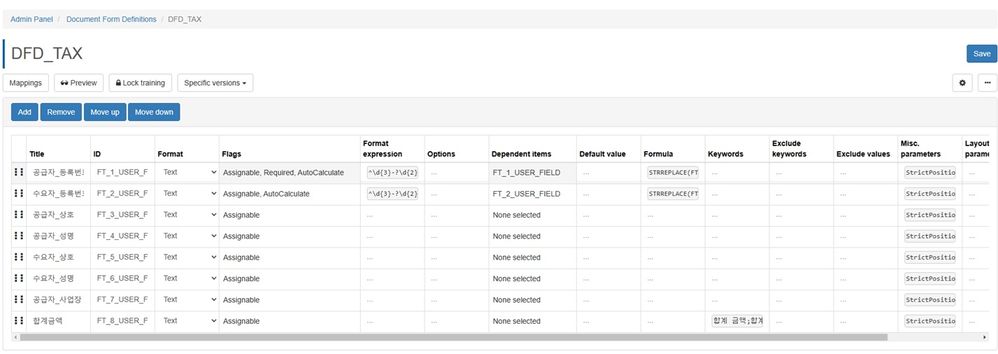

I made a DFD definition like below
Format : Text
Flags : Assignable, Required, AutoCalculate
Format Expression : ^\d{3}-?\d{2}-?\d{5}$ <---- an expression for tax number
Dependent Items : FT_1_USER_FIELD
Formula : STRREPLACE(FT_1_USER_FIELD, " ", "") <---- Aims To get rid of empty space
If anyone has encountered and solved a similar problem, I’d greatly appreciate your advice. Thank you!

Hi @Sangjun ,
I would recommend removing the formula and deselecting the Auto-Calculate flag as there is potentially a more efficient way to remove the unwanted space.
You can use the misc parameter "RegexMode" and set it to "2", which uses a fuzzy matching method and can automatically remove unwanted spaces.
You can see in my example where I'm using the expression [A-Z]{2}[0-9]{5} that the space is causing an error.
I then set the Regex Mode to 2.
And retry the same document, this time the space is removed by Decipher.
Ensure you test this with other documents as other characters can be replaced e.g. o can be changed to 0.
Also when using a formula like this, it's best to use the special variable SELF e.g. STRREPLACE(SELF, " ", "").
