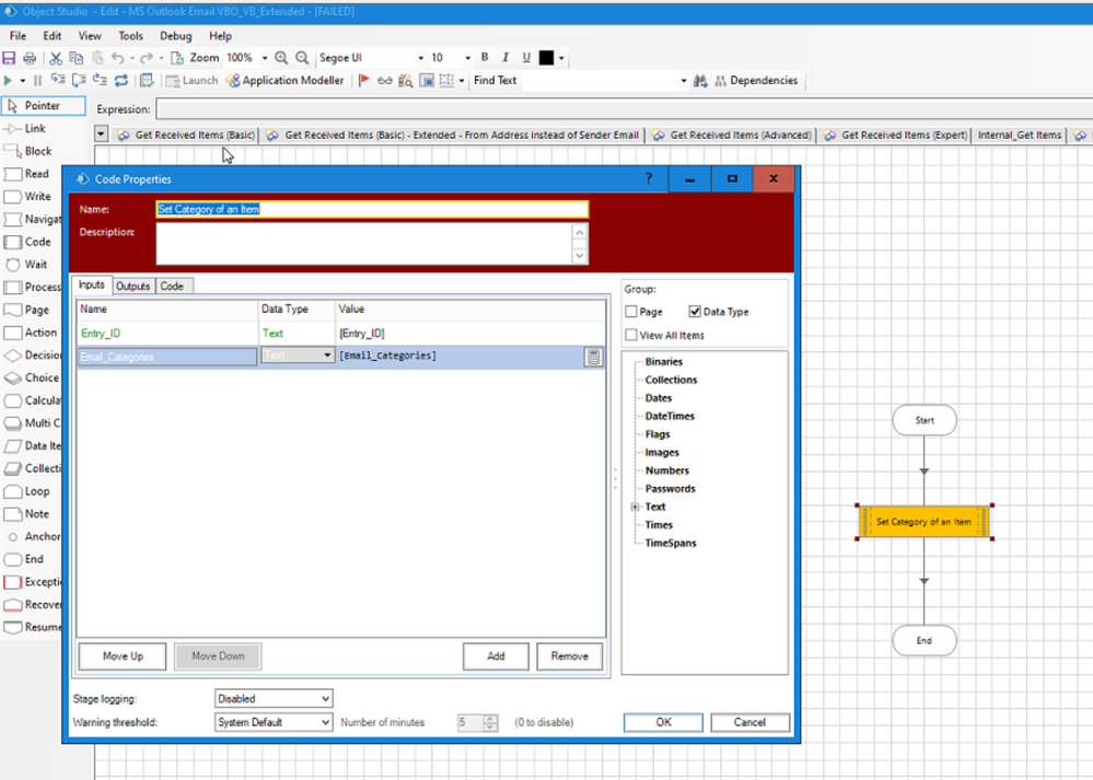

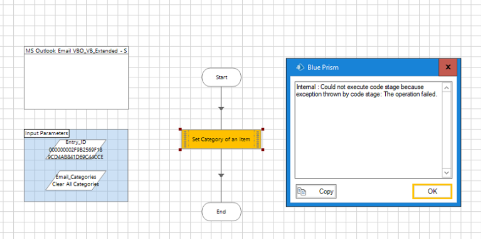

I am getting below error in BP where bot is trying to forward emails. In some cases its working fine.
I need suggestions on how to fix this issue.
ERROR: System Exception : Issue with Outlook interaction for Set Category of Email Item, due to Exception Type : Internal and Exception Detail :Could not execute code stage because exception thrown by code stage: The operation failed. at the Stage : Clear any Set Category for Item
david.l.morris
Level 15
What object are you using? MAPIEx or MS Outlook Email VBO or other?
