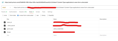

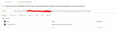

I have got this working in Postman without issue and wondered if you could offer some support in getting it working?
Here is a breakdown of the settings in Postman and Blue Prism:
Postman:
In postman it’s a very easy setup and the bearer token generates without issue

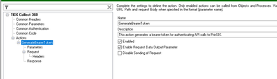

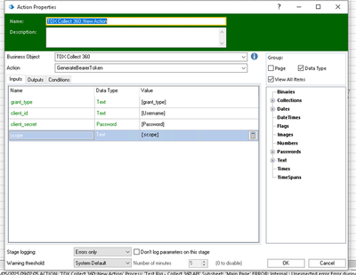

I am passing in the Parameters (I have also tried hard coding in the Service) to the action created by the Web API Services:
Inside the Web API Service:
Common Headers:
Common Parameters:
Common Authentication:
Common Code: (this is where the issue might be, Do I have to pass anything into this?)
The Action:
Parameters: ( I have tried the parameters that I am passing in, in here as well as mentioned above in the common parameters. I have tried to hard code them and pass them in from the calling process)
Request: (I have tried adding code to the Body Content but it didn't seem to work and I got compiler errors, code I tried looked like the following?
  "grant_type": "[grant_type]",
  "client_id": "[client_id]",
  "client_secret": "[client_secret]",
  "scope": "[scope]"
Also tried hard coding the values
Headers: (I tried adding Accept and Content Type here as well as the Common parameters above)
Response:
