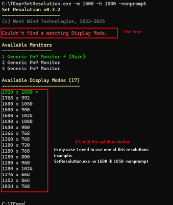

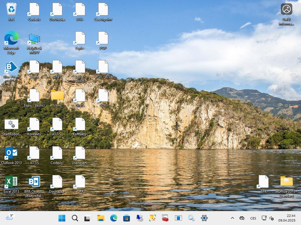

09-04-25 09:51 PM
it does not work for me. It lists the profiles but when I call the program with parameters the resolution stays as before. I am attaching the screen shot I am taking after calling this exe.
Regards
Zdenek
10-04-25 03:54 PM
I have an issue when using an invalid resolution, so the command returns the possible resolutions that you can use. I changed it to follow that, and it works fine.
If that doesn't work for you, show me a screenshot of the response from the program after running the command, just like in my example:
