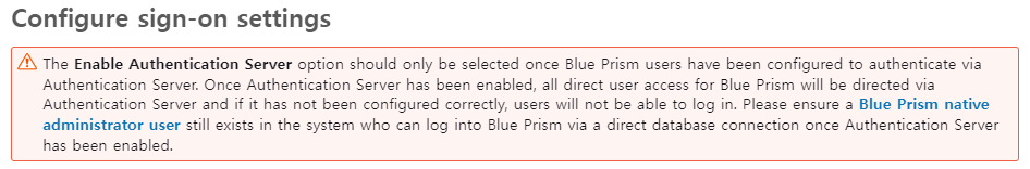

Keep in mind this attention when installing Authentication Server.
Fortunately, a direct database connection will allow you to log in, so give it a try.
