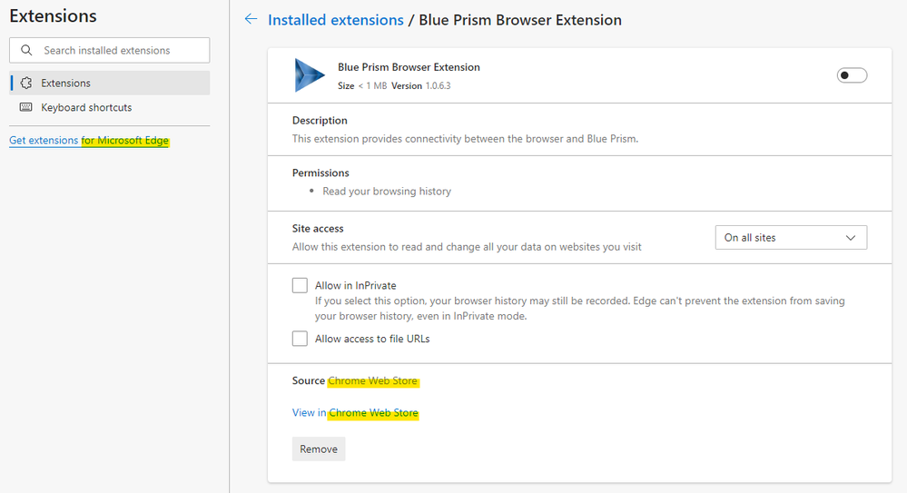

I just noticed, when having Chrome and Edge installed on the same machine, Edge automatically imports the Chrome Extension.
We have Chrome and Edge installed on our workplaces and having Chrome extension for Blue Prism installed but no extension for Edge.
When opening Edge and view the installed extensions, also the Chrome extension is shown. The link redirects to Chrome Web store and a message in Edge informs:
What is the difference between the Chrome extension and the Edge extension?

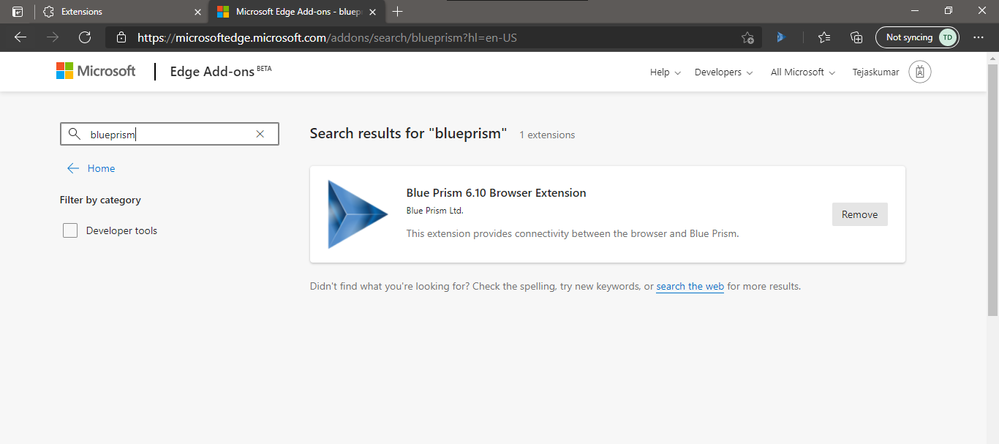

I checked in my machine and I've separate extension for Chrome and Edge because both of them have their own store to get extensions. You can go to edge extension store and download it for Edge. Same goes if you want it for chrome open chrome extension store to get it.

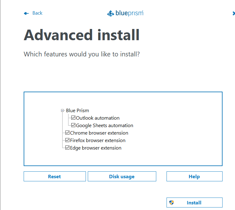

One more alternative is to click on change option in programs for BluePrism and install from the setup file.(SS attached)
Edge and Chrome both built on the Chromium open-source browser so in the backend they're more similar than they are different. (Perhaps that is the reason extension is same for both Edge and Chrome)

In 6.8 (which is when Edge Chromium automation was introduced I think), it was slightly weird where the Chrome extension was installed in Edge. But, starting with 6.9, it's actually a separate extension that is in the Edge extension store. Now, whether it's actually a separate build or not, I've no idea, but it's no longer weird to install as of 6.9 and onward. 😃 And I believe that all of the extensions are installed automatically in 6.10+ so there's no manual effort other than configuration of the extensions such as enabling Private mode or whatever.
