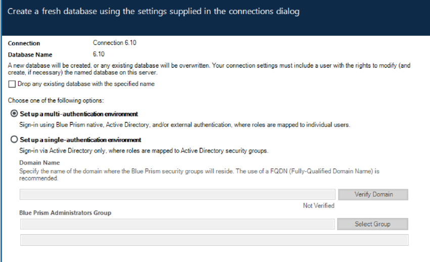

I have a scenario where my customer is using multiple Domains in Azure Active Directory in Azure cloud. Now in order to cater multiple domains. Please suggest on the step as shown in the screenshot below.
1. Do i have to create multiple connections for multiple domains while creating database?
2. Is it possible to use comma separated Domain Names on a single step as per below?

Hi Saurabh Goswami,
Which version of blue prism are you planning to install?
I don't have definite answer for version 6 but in version 6 we did some thing like one trust domain as mentioned in the below Article( Although it is indicating as version 7.1 and 7.2)
If you are using version 7.1 or 7.2 below article will help to add multiple domains.
Version 7.1: https://bpdocs.blueprism.com/bp-7-1/en-us/helpActiveDirectoryDomains.htm#
Version 7.2: https://bpdocs.blueprism.com/bp-7-2/en-us/helpActiveDirectoryDomains.htm#Addadomain
