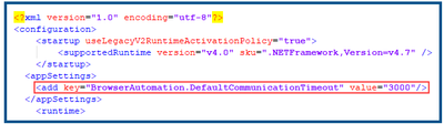

Changing this parameter in Automate.exe.config didn't work as well.

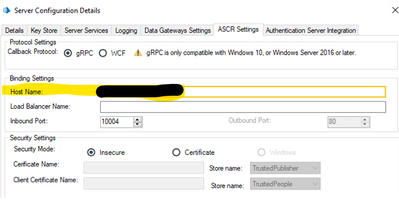

However, we came across a new issue this while upgrading our test environment, the below popup seems to appear when I try to run a process on a machine. Once i click Ok, I am able to see the pending session and run the process after another appearance by the same pop-up. Any thoughts @John__Carter  or others in this chat.
Hello @maneesh.vemula1 .
on your application server, call bpserver.exe and change the hostname from "localhost" to the complete FQDN (host + DNS domain).

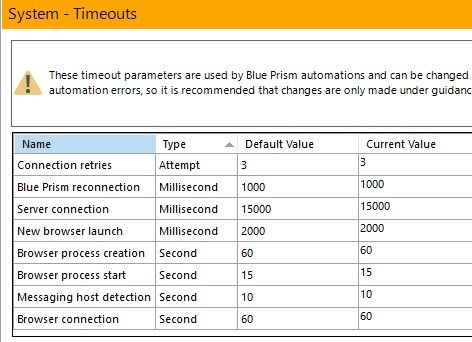

I know that this thread has been dormant for a bit.  I have seen a couple of similar threads start up, but I came across something that [unfortunately] caught my attention.
For context, a number of us have found, or, in my case, been directed to a set of configuration settings for the BP 7.3 browser extension.  In my case, I never saw an appreciable difference in behavior (err, behaviour) when tinkering with these settings.
Fast forward to today.  I was poking around our 7.3.1 installation looking for something unrelated when I noticed that in the Systems tab, under Systems/Timeouts are seemingly very, very similar configuration topics and familiar looking values (see the attached picture below).  The one that has me really wondering is the 'Messaging Host Detection' value because 10 seconds seems to be right around when the exception would kick out.
So, question 1 is, 'Are  the two sets of controls completely distinct?  Or is there [a lot of] overlap?
And, question 2 is, 'If they do control the same (or very, very similar) settings, which one takes precedence?' It feels to me like the System tab values come into play first.
BP 7.3.1 Timeout settings
