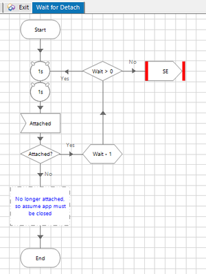

My guess would be that there is something between the end of the loop and the start of the next iteration. Try a Wait for Detach loop after you close, as a means of being (more) certain that everything is ready for the next cycle. Sometimes apps are slightly slow to close, and your automation can be trying to relaunch too soon, before the app is ready.
