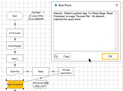

currently i am more than confused. I managed to open a PDF and to Spy certain elements in that File because i cant just copy and read the clipboard in this case. After i run the process a second time, suddenly the element is not found anymore:

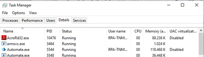

I just have one Process running so i dont think that is the reason
Also suddenly the Applicationmanager cant find the certain Fields in the File, it just can spy the whole file.
After i click manually in certain fields in the file, the Applicationmanager is able again to find the fields. Focus, Attach and Activate doesnt solve the Problem.
I Really dont want to Global Mouseclick and try to find the Fields in the PDF with X Y coordinates, so the spying process is working again. is there a better soloution?

I found some kind of soloution. I Tab to the Element and try it 5 times with 5 sec delay. That works but feels very odd

Here are some suggestions for your issue:
1) Use the Activate application after attaching and before the read stage.
2) Focus on or highlight the element before performing the read action. Since you're running in debug mode, the element may not be in focus.
3) A better option might be to read the entire screen after opening the PDF and perform text operations downstream. This has worked well for me in some use cases.
4) Run it in step-out mode instead of stepping through each stage to avoid focus and highlight issues

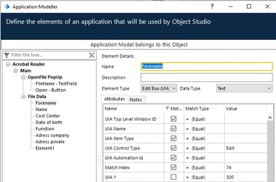

Hello together and sorry for the late reply. I got it working with the spymode and gave the Elements an ID f.e. Forename is ID 76. The Problem that now occurs is that theese IDs can randomly variate. I deactivatet Java Script and set "only read visible Page" but still the same problem.
