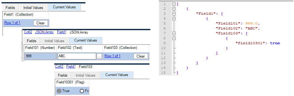

19-02-21 09:06 AM
Hi Thomas - take a look at the Utility JSON object. If your C# code stage can generate a JSON string then you'll be able to use the utility to convert the JSON into a collection.
19-02-21 12:23 PM
Hi @John Carter,
Thank you for your reply. This might be useful, I did not know about this option. I've been trying it out a bit now and I see it creates a JSON:array between every parent and child collection. This is also visible in your screenshot.
Is there then also a possibility to get the net schema as a collection, meaning without the JSON:Array's in between the parent child collections?
Thanks!
Thanks!
19-02-21 06:40 PM
Hi @Thomas Warnaar,
There should be a public action on the VBO titled JSON to Collection (skipping JArray). That action will create the collection w/o the interim JArray.
Eric
Eric
22-02-21 11:48 AM
Hi @ewilson,
Our BP install doesn't seem to have that option. Could I maybe import it from somewhere?
I'm wondering now if there are other usefull options we're missing...
Sincerely,
Thomas
Sincerely,
Thomas
22-02-21 12:32 PM
@Thomas Warnaar,
You may have an older version of the Utility - JSON VBO installed. You can find the latest release on the Digital Exchange.
https://digitalexchange.blueprism.com/dx/entry/9648/solution/blue-prism-json-utility
Eric
Eric
22-02-21 01:16 PM
I got the newest version from your link and it works a treat @ewilson, thank you!
