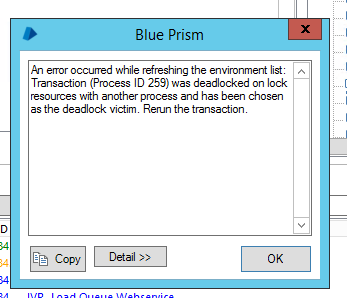

Hi All,
Just wanted to ask around if anyone has a known solution for the below error.
This happens when trying to navigate around control room - specifically when trying to look and monitor processes that are currently running.
Error message and screenshot below:
System.Data.SqlClient.SqlException (0x80131904): Transaction (Process ID 242) was deadlocked on lock | communication buffer resources with another process and has been chosen as the deadlock victim. Rerun the transaction.

Screenshot:

The issue is probably with size of database, you can find more info here http://portal.blueprism.com/customer-support/support-center#/path/1137390322
