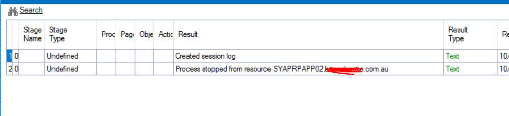

Is there any information out there as to why Blue Prism resources would stop a process on their own? No stop was requested and the only information available to us is that the process has stopped. is this happening because of internal error? after the process stops it neve logouts it stays idle!

We've seen this when the application/database servers are busy doing maintenance related tasks and the connection essentially times out. Unfortunately there is no real workaround we've seen other than to try and avoid processing when the servers may be performing maintenance activity.
How long is the timestamp between that first line in the log and the second? Does this happen often or you just happened to pull out this one time?
Few seconds
Happen few times this week.

I wouldn't say it stops itself - rather it is trying to communicate back to the server (to talk to a queue, to update a workitem, etc) and does not get a response. As such, the process will instead stop running since it can't perform the next action.
If its happening often I'd check the error logs on your application server for the listed timestamps and you should see some entries around this resource - I bet you'll find something there to look into.
