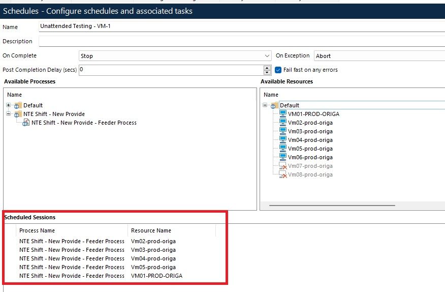

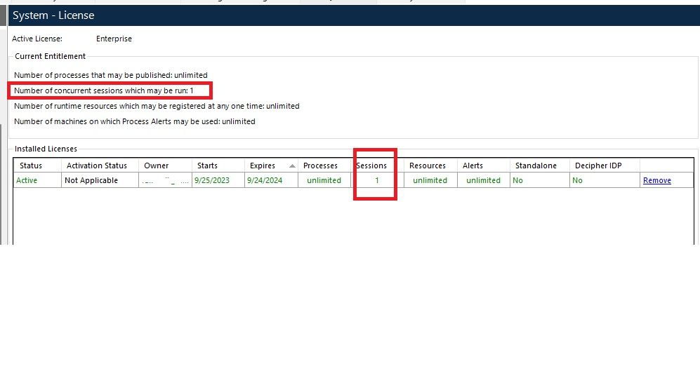

I am writing to seek clarification regarding the handling of concurrent sessions in Blue Prism. My current license permits only one concurrent session at a time. During a recent test process executed in the control room, I observed a discrepancy between running the process manually and executing it through the scheduler. I am using Blue Prism Version v6.10.5.

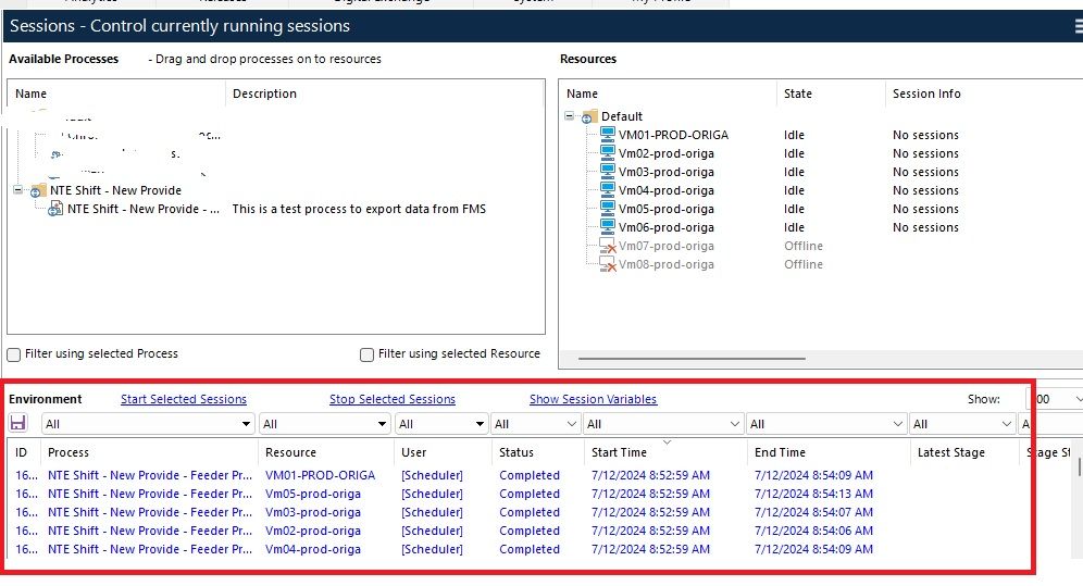

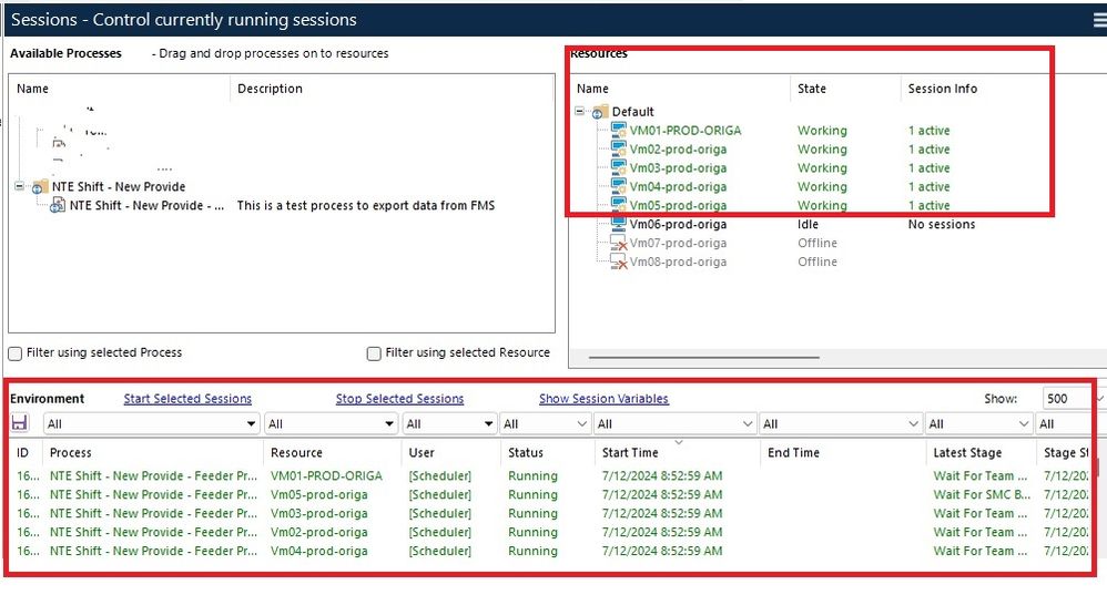

2. Scheduler Execution:
When I use the scheduler and select multiple runtime resources to execute the test process, I am able to run multiple sessions of the same test process on multiple runtimes simultaneously without any errors. This behavior appears to contradict the license limit of one concurrent session.
Please find the screenshots below for reference as mentioned above. I would appreciate your assistance in clarifying this matter.
