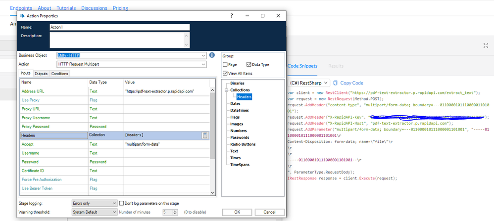

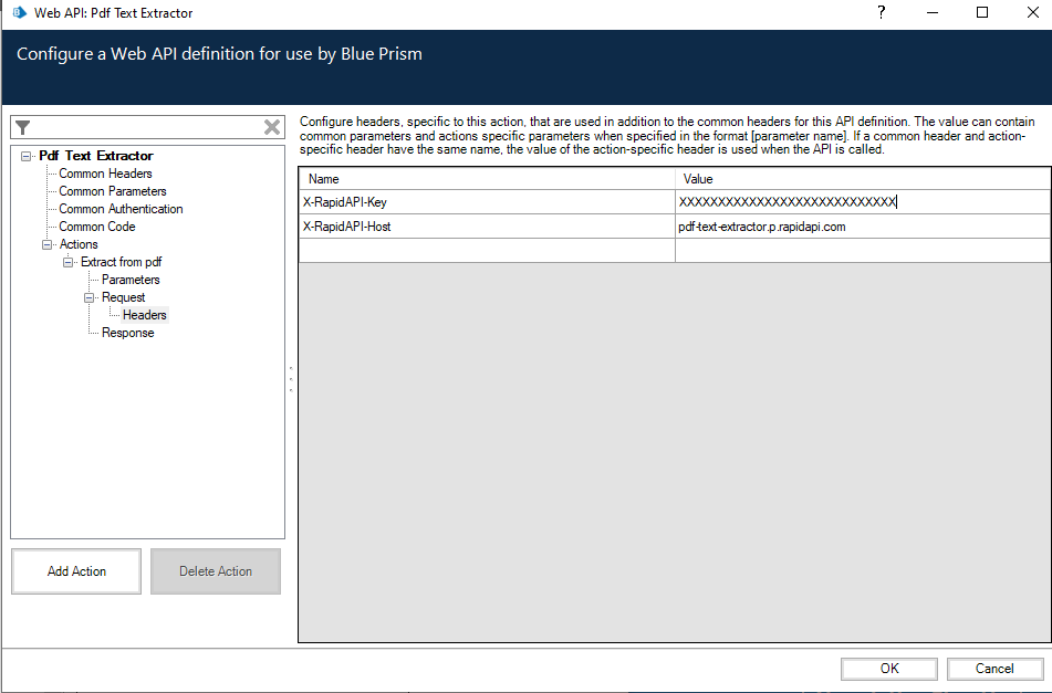

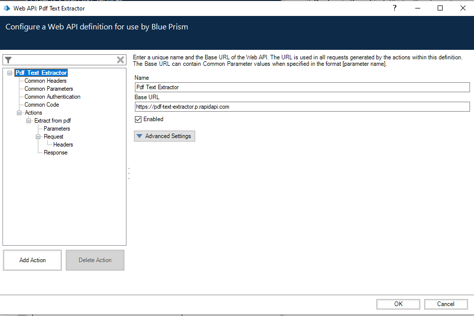

so i put this value in blue prism
30820.pngInside my headers i have :
Inside my request i put :
the purpose is to add a pdf file from my pc and then get the text inside it.
PS : i tried to put the header content-type but it failed.
I tried also to put files as a parameters but it failed too...
I tried to put "multipart/form-data; boundary=---011000010111000001101001", "-----011000010111000001101001\r Content-Disposition: form-data; name=\"[file]\"\r (file as input parameters) but same result nothing work...

Dear @Bruce Liu thank you for your answer.
I have installed the vbo
can you guid me please to put the elements ?
for the headers i put it like this but its not working:
i putted content type as a third column in the header but same result its not working.
Any idea ?
