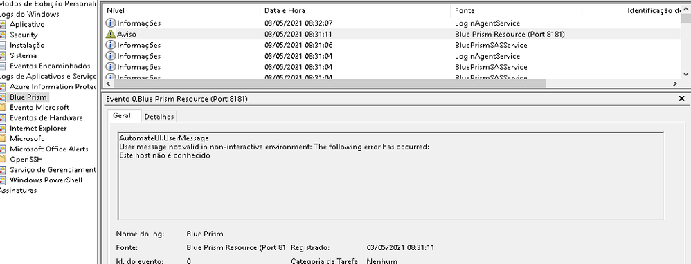

A few days ago a virtual machine from the environment, already exists and that until then always had good functioning started to present the error "Connection Lost" in the control room
The error is reproduced when I restart the virtual machine. Through the windows event viewer log, I see that it connects to the blueprism server, but soon after that it loses the connection
Then if I log in to the virtual machine, the connection will work again and it will have the status idle in the control room

We found the problem and it is in the initialization of the network card
We changed the BluePrism Login Agent service to start with a delay, problem solved
