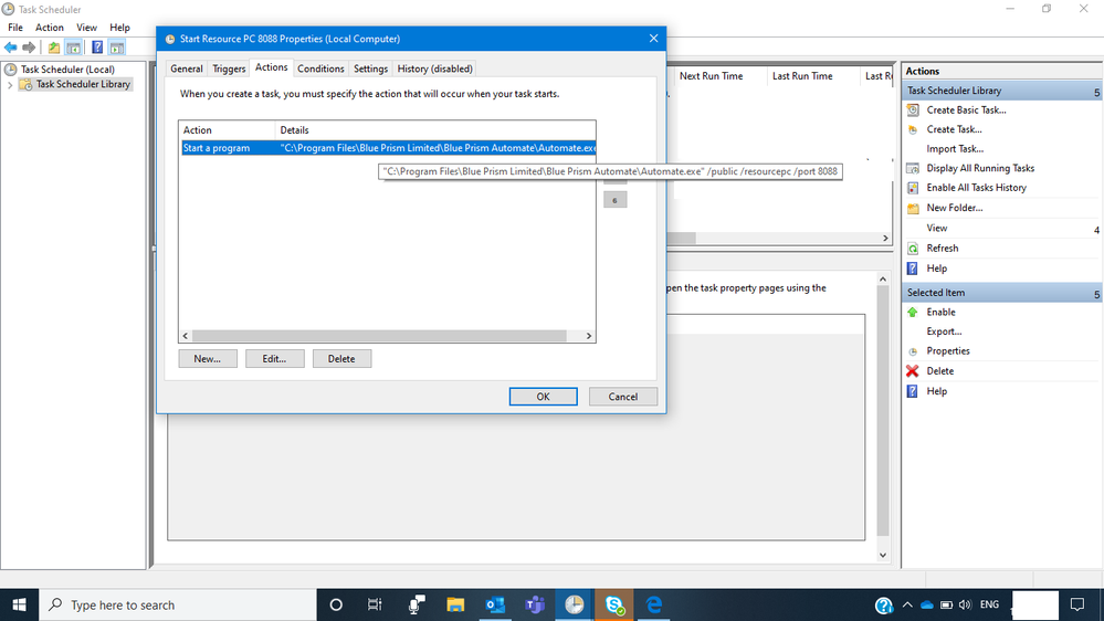

You have the runtime resource defined as a task at start up. If you look at that task in task scheduler, you'll see something like this:
"C:\Program Files\Blue Prism Limited\Blue Prism Automate\Automate.exe" /resourcepc /public /invisible
If you remove "/invisible" from the command, the runtime resource window will appear when it starts up. Be advised though that the presence of the window on the screen may interfere if any process running.

Attaching screenshot also.

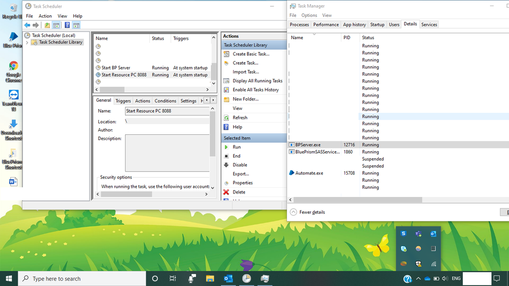

19-02-20 06:55 PM
What version of BP are you running? Also, you don't have this icon in your system tray?

BP version 6.5
Exactly! I don't see the resource pc icon in the system tray.
