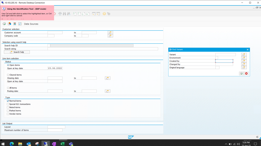

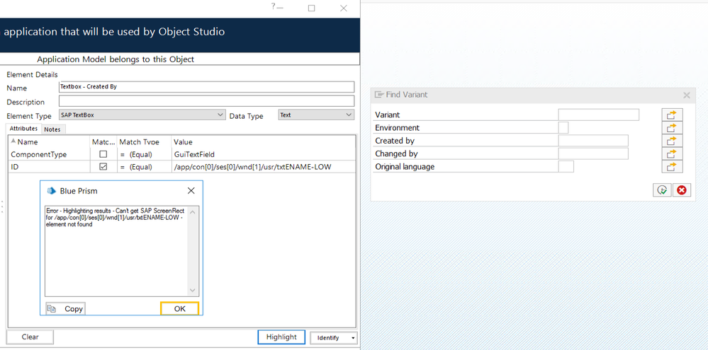

Existing application module elements are not matching and I can not spy elements newly because none of the spy modes are recognizing the required fields.
Error screenshots FYR:
Please guide me with your valuable suggestion to over come this issue which is a high priority task

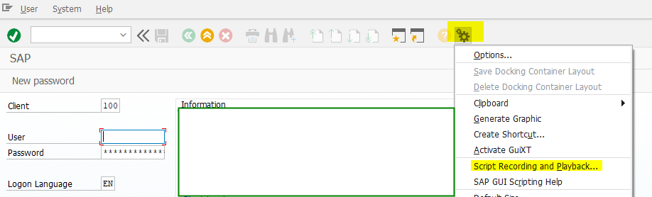

If none of the spy modes appear to working with SAP it could be that sap scripting is turned off in SAP. If you look at the options and check if scripting is on and if not you would need to enable it to identify sap elements.

Hi Vasant
Further to Michaels's reply, if you check in SAP as shown, if greyed out, then scripting is not enabled in SAP.
