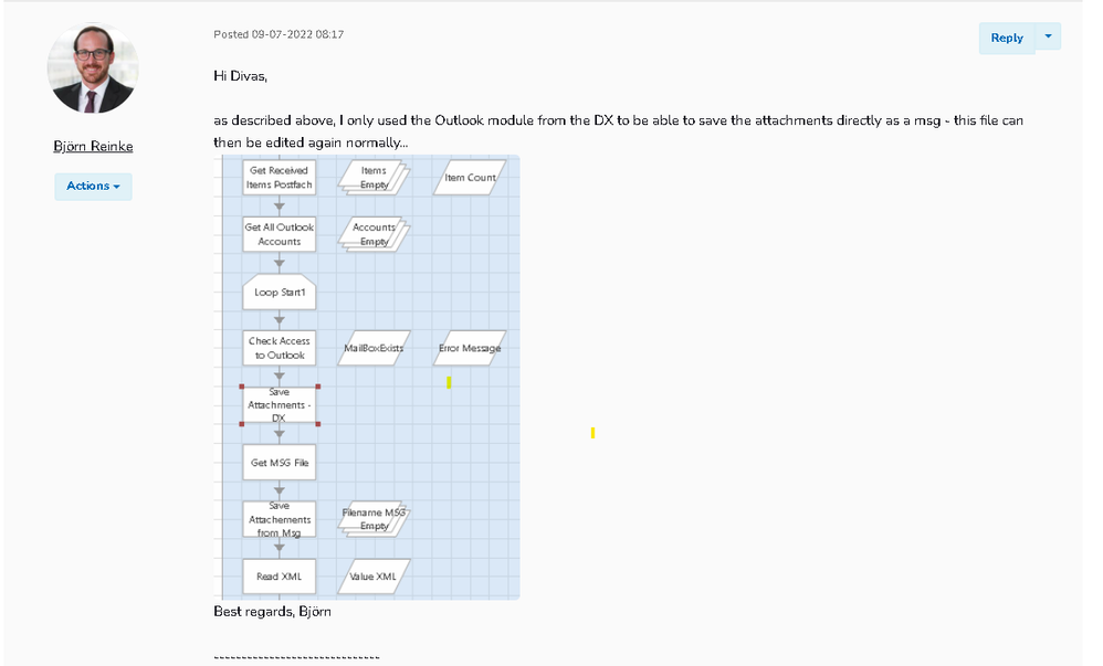

Hi Rafael,
Check the solution from user Björn Reinke and if it helps you with the problem you are facing, I faced this problem a few years ago:
