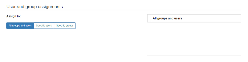

Hi Red,
Great to see you're making progress towards production!
So let me confirm I understand the question. You're looking to separate your documents which are owned by different business teams, so for example someone in Finance can't view an HR document and vice versa?
If so you can create user groups to reflect this and then add the respective users.
Then in Batch Type you can assign them to the respective groups (you must also include the user running the Decipher clients, by default this is generaluser).
One caveat here is that if these users have access to the reporting tab, they will be able to view each others data in the Field History report. Currently there is no segregation available on the report tab.
That being said I'm working on a report you can run from Blue Prism, due to be release along side 2.2 (though it should work with 1.2 if you have the separate reporting database). And we're aiming to get these updates in the product for 2.3.
Let me know if I've missed the mark or if you have any additional questions.

Thanks Ben,
It has been a while since we set up the document side of things that I did not even think about it.  That make sense, it is just the reverse perspective of what I was expecting.
As a 'By The Way', we are currently on Decipher v2.1 and also have a seaprate reporting database.  I can reach out separately to see about trialing the report.
