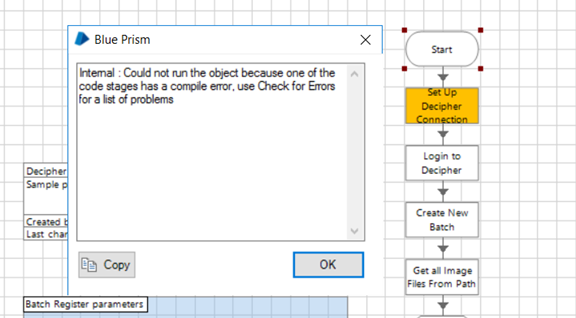

Set up Decipher - Could not run the object because one of the code stages has a compile error.

Hi, David,
did you copy the dll (BluePrism.Decipher.VBO.Interop.dll) into Blue Prism program folder where you run Decipher process? This is typical message when you forget this.

Hi, David,
I wanted to ask if you found the solution to this?

Hi Mobeen,
It's likely Zdenek's suggestion resolved the issue. Have you tried this? Do you need further guidance?

Hi Ben,
Really appreciate your concern. I found the issue was with the VBO it self it wasn't the latest version due to which some parameters were not being sent in the code stage. After updating the VBO this issue has been resolved.
