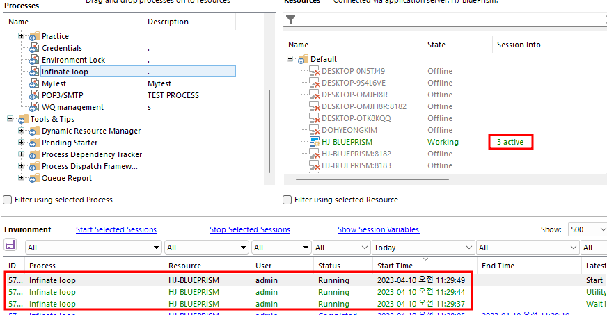

Can anyone clarify? What is the criteria that one Runtime Resource can execute multiple processes simultaneously?
Please see my test below and let me know if this approach to test it is incorrect.

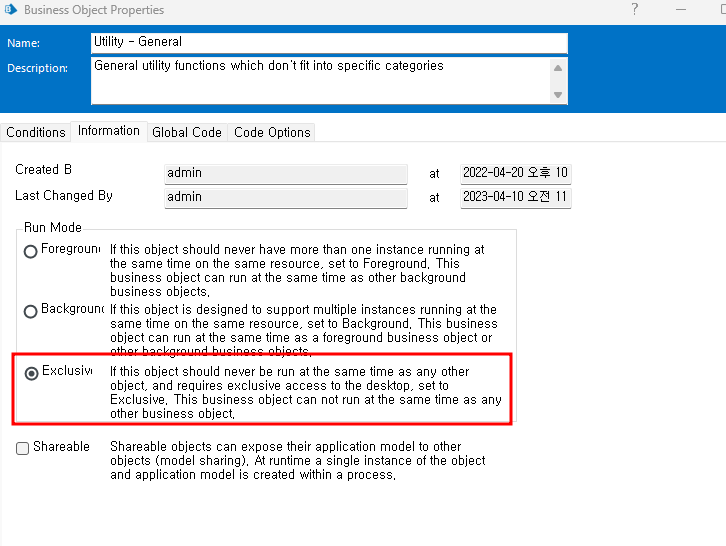

At the first glance, I thought it would be depending on the Business Object's Run Mode such as Background, Exclusive, etc. But it seems not to do with it based on my simple test as shown below.
1) Setting the Run Mode of the Business Object to "Exclusive"
2) Create a process that's using that Business Object, allocate the process to one Runtime Resource multiple times.
When the Run Mode of the Business Object changes to "Backgroun", the result was same.

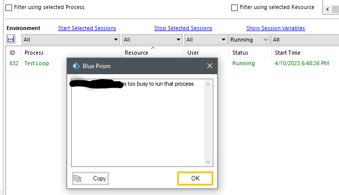

I've tested this before and it was not letting me run multiple sessions. I retried today same as you mentioned using Utility - General and it does not allow to the creation of more than 1 session due the object being in Exclusive.
Wondering why not working for you!

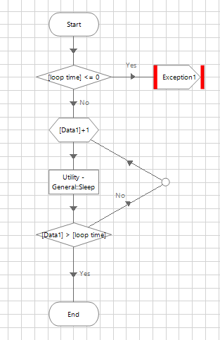

Yes, I did double check the Dependences. The test logic itself is as simple as it's shown below.

In the meantime, I spotted the 'Run mode' of the Process is not properly updated in the database while the 'Run mode' of the only Business Object used by that process changes e.g., from "Exclusive" to "Background" and vice versa. I think there needs to be a deep-dive on this and raised a ticket.
