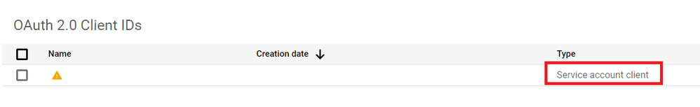

I tried a slightly different quick start guide. In this case I used the guide for .NET which makes more sense to me than Go since the Google Sheets VBO is using the .NET libraries. Here's the link to the guide:
https://developers.google.com/sheets/api/quickstart/dotnet
When I use the Enable Google Sheets API button in this guide, it creates a Service account client type ID for me.

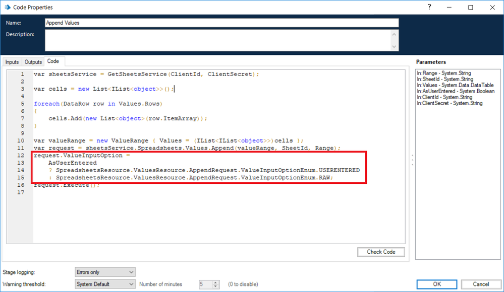

If you open the VBO in Object Studio you should see, within the code stage on the "Append Data" action, that ValueIputOption is being set based on whatever you set the input data item "AsUserEntered" to. Are you setting that flag to True or False?
Ultimately, this value is added to the query string parameters of the HTTP request, so it looks something like this:
https://sheets.googleapis.com/v4/spreadsheets/13123/values/A1%3AB1:append?includeValuesInResponse=true&valueInputOption=RAW​

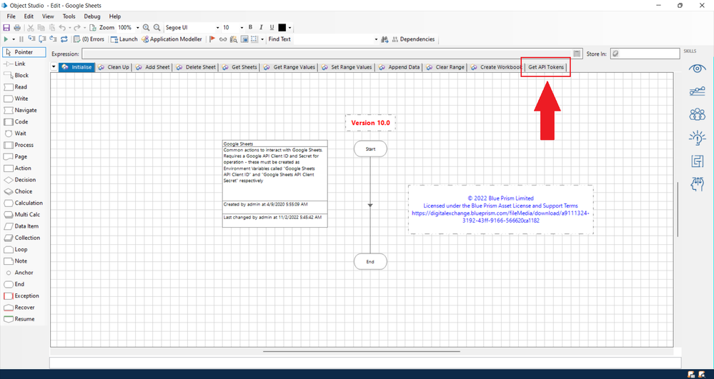

So you have no action on your Google Sheets VBO named Get API Tokens? Are you sure you're using the Google Sheets VBO and not the Google Sheets API connector?
