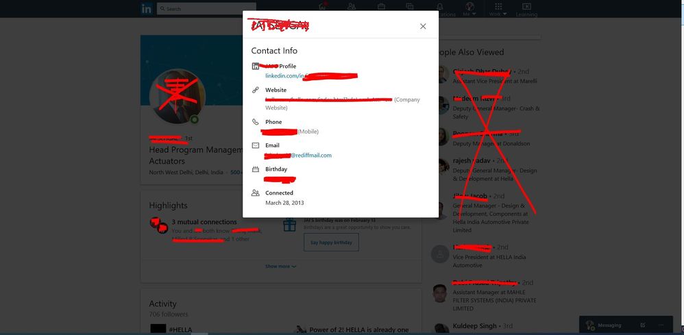

Hi All,
I am trying to spy email and mobile number  data from a web window which appears after clicking the link as shown in picture.It is linkedIn profile of a user and when "Contact window"is clicked ,the contact detail window opens up.
I have tried all spying modes ,it works for once for a contact which I spy in application modeler but does not picks up when contact is changes.
I used Accessibility mode,HTML and UI mode to read the value didn't worked,
I used region mode by using relative,coordinates and anywhere ,didn't worked.
Need your thoughts around it if someone has gone through same issue. Apologies in advance to cover contact's Personal details.

I completed the project where I was encountering HTML spying problems.
Sharing some takeaways and lessons learned-
LinkedIN works on Chrome
LinkedIn doesn't work properly on IE or is not compatible with IE,runs slow and Heaps of problem while spying.I completed this project on "Chrome,worked perfectly and web pages and elements loaded.The problem I encountered was with entering data using "Global Send Keys",so below is the configuration of "Navigation Stage" for use of Global send Keys in Chrome:
2.Spying Web Page Overlaid Window to read values.
Spied with Region mode and in used Intelligent wait stages to check and get values.(Ref to my query above)
