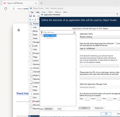

I am developing my first Edge automation. Blue Prism extension is already enabled.
I am trying to attach to attach to already launched website. When I click on Attach on Application Modeller, instead of attaching, it will launch the website again. Then when I click on Identify button, error appears as "There was an error during spying operation". When I try to close the UI and attach again, it will again launch a new website, for a second Identify button will appear and it will switch back to attach again.

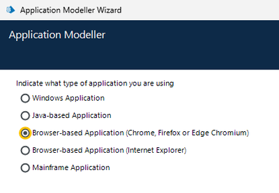

next verification, can you please click on application wizard , click on next , and see here which broswer mode you have selected .
Its Browser-based application (Chrome, Firefox or Edge Chromium)
and the website I have opened manually is on MS Edge

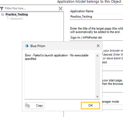

i created the new object and its working fine for me, can you please try creating new object ,
what i am thinking is , initially you might have selected Internet Explorer because when its did not identify the target window that time you got IE related pop up error, for me i am getting different error if its not identifying the window.
my suggestion is , try creating all new object with all correct steps.
i entered incorrect window title and tested and i got this error message
