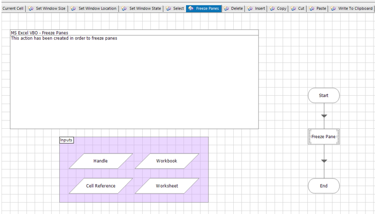

Create a new action called 'Freeze Panes' within the 'MS Excel' VBO object which consists of other actions. Add the following input parameters to this action:
- Handle (Number) : The instance of the excel sessions held in the dictionary to establish the current excel connection.
- Workbook (Text) : The workbook name returned while using either 'Open Workbook' or 'Create Workbook' actions.
- Worksheet (Text) : The worksheet name where the operation needs to be performed.
- Cell Reference : The cell address from where the freeze pane action needs to be performed.

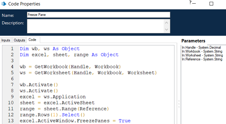

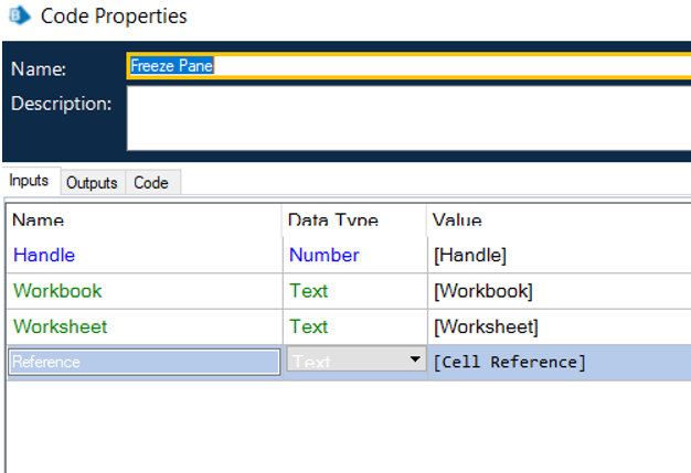

Add the code stage named 'Freeze Pane' with the following parameters and code:
Code:
Dim wb, ws As Object
Dim excel, sheet, range As Object
wb = GetWorkbook(Handle, Workbook)
ws = GetWorksheet(Handle, Workbook, Worksheet)
wb.Activate()
ws.Activate()
excel = ws.Application
sheet = excel.ActiveSheet
range = sheet.Range(Reference)
range.Rows(1).Select()
excel.ActiveWindow.FreezePanes = True

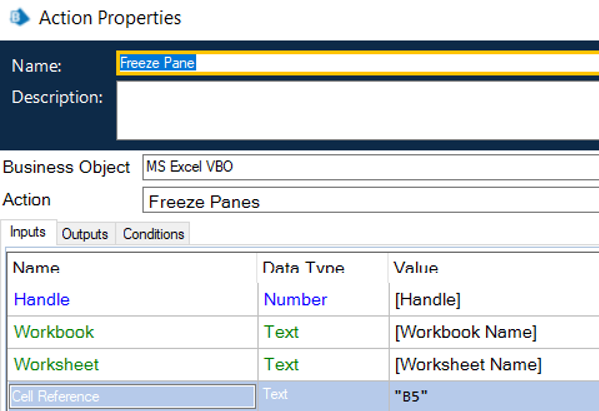

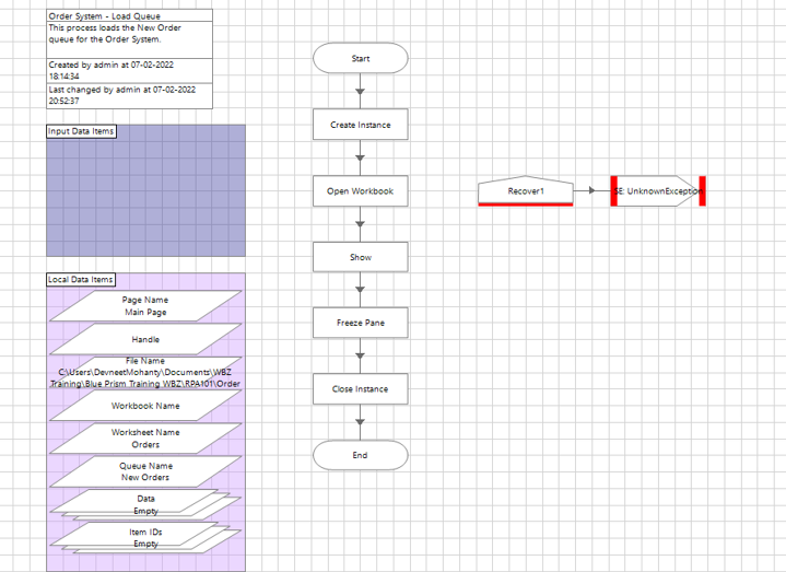

Test Scenario:
I have created a workflow and provide the parameters for 'Freeze Pane' action as follows in the process studio:
NOTE: Ensure that all the actions are used from the same VBO where Freeze Pane action has been created in order to avoid unexpected errors.

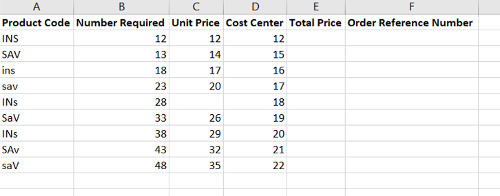

The input file before execution looks like below:

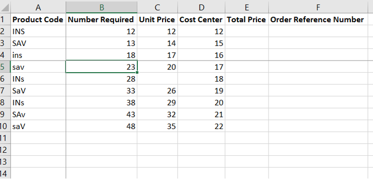

Upon executing the workflow, the results are as follows:
Here, the freeze pane has been added at the given cell reference. Also, please find the attached sample business object for your reference.
