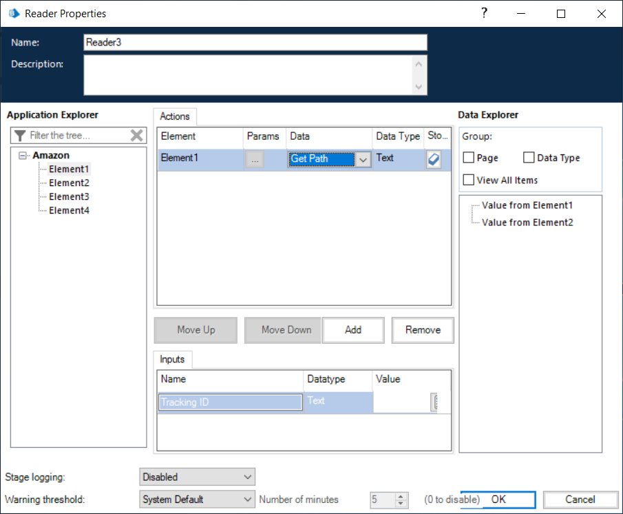

23-09-21 11:42 PM
Hi Shri,
You need to use a read stage and then it will reveal the option. I believe 'Get Path' was added in BP v6.5 so it is more likely you should have it than not.
See screenshot below:
Bruce Liu
Australia/SydneyBruce Liu
Bruce Liu
24-09-21 10:56 AM
Hi Bruce,
Thanks for the response. I am using BP 6.4.2. May be that's the reason I am not getting it.
