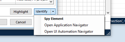

Hi @Shanmukha Gajula Try to spy using HTML mode with application navigator. You may not able to highlight the particular element even after spying but you can able to ​​click on back end. If you will get that element and you will Click Center function then it will work perfectly. Other wise you can inspect that particular element and use that property in Application Modeller.
Please let me know if you have any doubt I will help you on that.

Did You try to get elements tree using below navigator options? maybe functional element cannot be spied in standard way as it is overlapped by other element (it happened to me couple of times)
Other method that you can try is to collect coordinates of spied element and use global mouse click on the element - it should work.

Sure @Michal Szumski.
