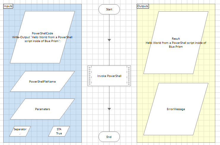

I have modified the code of the VBO a little bit to make it possible to store the PowerShell code inside the object. Now it is possible to select whether the PowerShell code should be loaded from an external file or if the code is passed.
Best regards
Stefan

here a slightly extended version.
Best regards
Stefan
